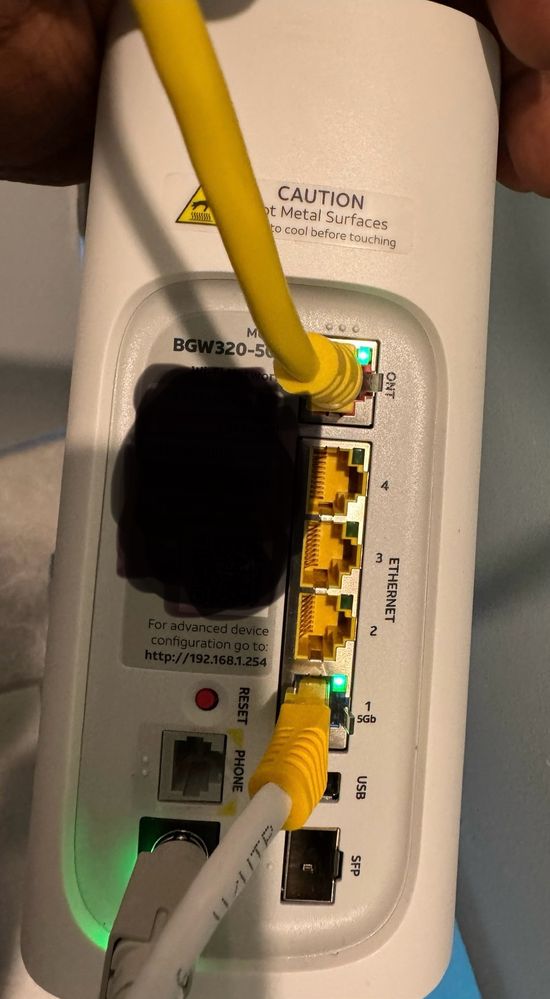

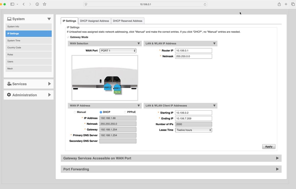

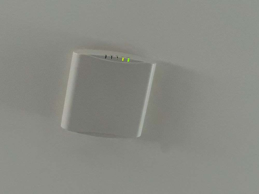

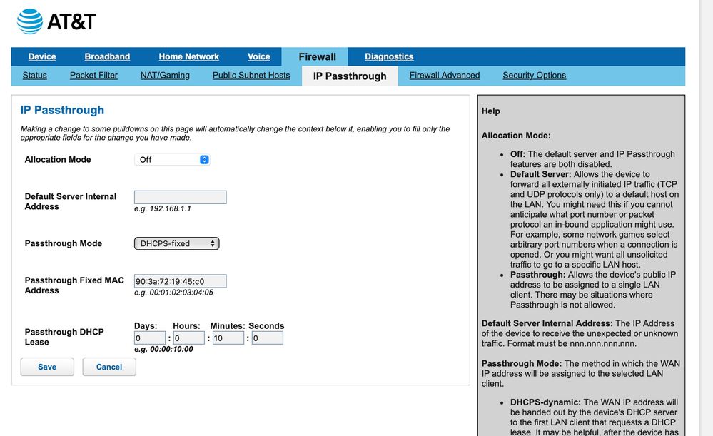

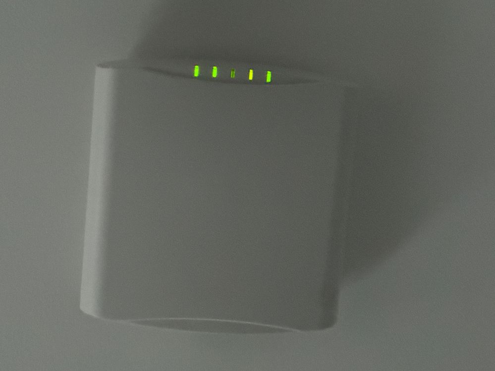

I would appreciate it if you could review my earlier messages and attached screenshots to help identify the root cause, rather than providing general suggestions.. I am not able to do SSH to any AP due to the credentials. i don't see the the option to attach screenshot to share my setup.At_T dashboardAt_T dashboardAT&T ModemAT&T ModemMaster APMaster APMaster APMaster APMember AP is blinkingMember AP is blinking

I performed a full factory reset on all Ruckus Unleashed APs and attempted to configure the network in Gateway mode. However, in this mode, the Member APs do not join the Master AP automatically.
When I reconfigured the Master AP without Gateway mode (i.e., Bridge mode), the Member APs joined automatically and functioned as expected. However, in Bridge mode, I’ve observed intermittent issues with internet performance – including sluggish speeds and occasional failures to load mobile apps (particularly when switching between Wi-Fi and web browser or between APs).

In Bridge mode, the Unleashed setup works, and I’m able to successfully add all Member APs. However, I’ve noticed the internet feels sluggish, and when I connect devices to the network, the Member APs’ LED indicators don’t turn orange—which suggests that the devices are not connecting to the nearest AP, but rather defaulting to the Master AP.
