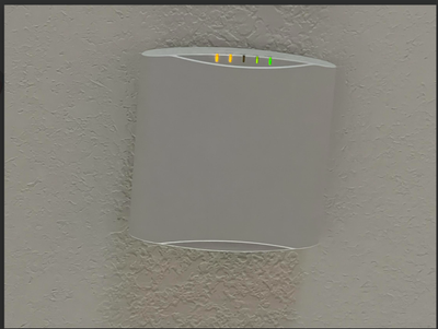

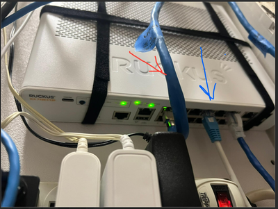

Please let us know which lights are on on the Switch. (Please refer to the below picture and share a picture of the same, showing the light status and the FULL Switch panel cable connections to the Switch ports)
Could you please let me know the light status on the Access Points? Any of these lights are on (Please refer to the below picture and share a picture of the same)

Here are the pictures of the Switch and the connected AP. The Blue arrow points to the connection from the Modem and the red arrow is the connected AP with the green / amber lights on the display.
