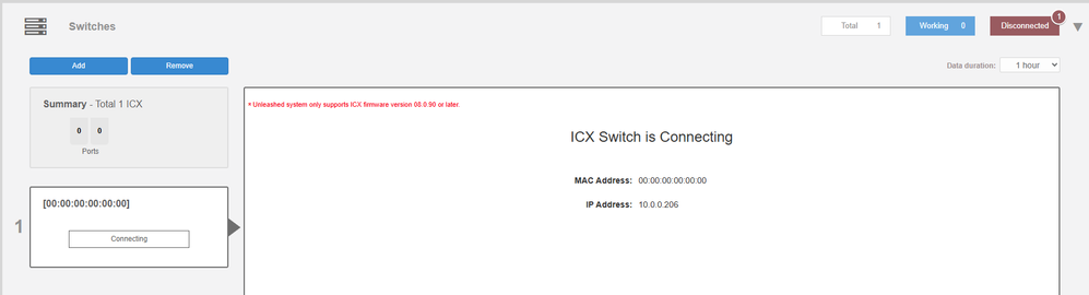

Switch showing Disconnected with MAC address all zeros
Hyland6885
Hello, I am trying to troubleshoot my slow network. On the dashboard my switch is showing disconnected and MAC address all zeros, I do have an IP address and a message "Unleashed system only supports ICX firmware version 08.0.90 or later. Can you assist? Thank you in advance

Hyland6885
Here is a screenshot. Also I am running version 200.15.6.212.20.

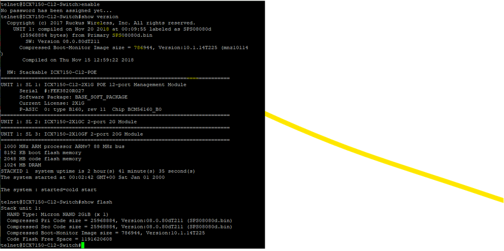

Hi @Hyland6885 ,
From the case description, I understand that you are facing issues with Rukus Switch and is showing disconnected.
Before we can help, we need to check which version the Switch is currently running.
To check this, we must identify the ‘current’ IP address assigned by your local router to the switch ICX-7150-C12P
ICX7150-C12 Router> OR
ICX7150-C12 Switch>
show version
show flash
pinky_ruckus
Valued Contributor III
Hello @Hyland6885 ,
From the screenshot you shared, , I understand that your RUCKUS Switch is on an older version(08080d) which doesn’t let you log into the Unleashed application. We suggest you upgrade your Switch to the recommended version(8095g) to avoid this issue in the future.
Please follow the below RUCKUS Lennar Knowledge base self-help article which will help you to upgrade the switch to the recommended version(8095g)
Please use the 2nd option from the article(using TFTP server).
Please follow the process explained in the article and let me know if you have any queries in this regard.
