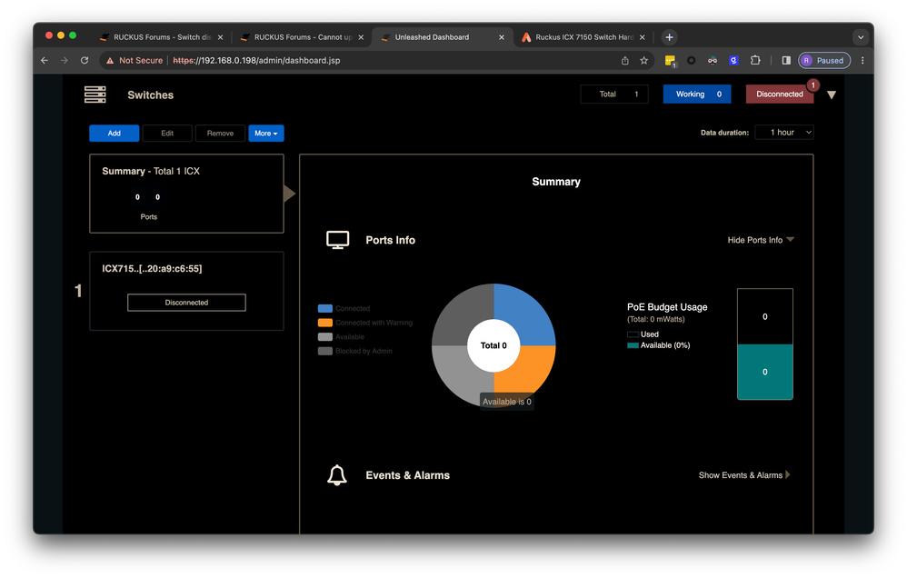

Also please share the screenshot of the image showing the status of the switch in the unleashed app.
07-14-2023 01:00 PM
Screenshot is here.
The status lights on the APs and the switch are now normal and the switch appears to be functioning in that we are no longer having issues with it like we did when it was in router mode. So at this point I'm just missing a config and the switch being active in Unleashed.
