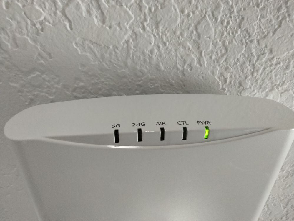

3) On the 510 AP the PWR is solid green and CTL is flashing green (photo below shows does not show flashing, but it is.
Please advise.  Thanks.

2) There is only one AP connected to the switch via Port #2 (see previous photo for lights on the 510).
