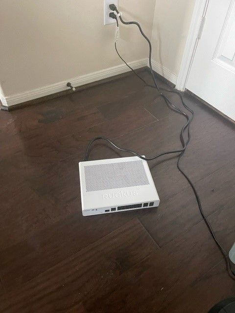

I have an ICX-7150-12p. The switch started to randomly power itself off. I swapped power ports and the same condition occurred. I swapped cables and the device is dead with no indication lights. Help.

The switch has no lights at all. Please see the attached pictures. The APs appear fine as I test them with another POE switch.

Hi @shobeav
Based on the description, seems that the switch is dead this unit should be RMA (return merchandise authorization) in simple words replace it.
Feel free to contact us via chat, comment you already have a post, copy the link from the post (URL) and paste it into the chat to start unit replacement.
