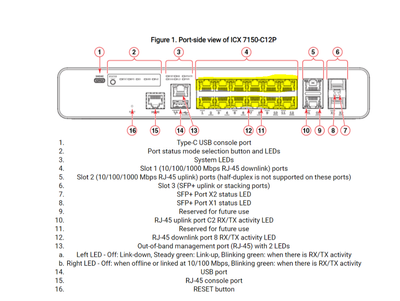

Hi @tomsanderson9
Ok, take in consideration that you can connect your Verizon fios router to any Ethernet data port as described in the picture below, now as you mentioned your technician has tested ports C1 and C2, so if he determined that those two ports are the only ones affected why didn't he move the connection to the other 12 available ports to fix your issue? I know your issue is not hardware related, however, if that is the case, please ask your technician to provide the diagnostics he ran from the switch, we have diagnostic commands for the cables and ports that I will provide in case your technician does not know, so you can share these diagnostic results, now if he did not gain access to the switch, not sure what kind of diagnostic he ran.
