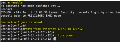

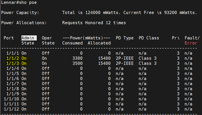

3:After the problem is fixed and the switch starts up again as expected, you can check with the following commands that PoE is enabled for the switch to provide power to your PoE devices
"show version": Will display the current firmware and partition booting.(May look like this SPS08090k,SPS08080F what you need to worry is that always start with SPS)
"Show poe": Verify the ports using PoE, consumption and current budget.(what you need to check is that the Admin State is ON for all the ports from 1/1/1 to 1/1/12, as you see in my example the port 1/1/2 and 1/1/3 are on but also are on in the Oper state, because are in use
Note: if for some reason are no on, let me add the commands to enable it back.
configure terminal
interface ethernet 1/1/1 to 1/1/12
inline power
