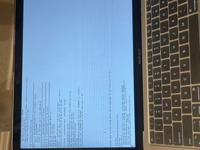

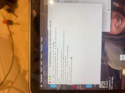

The picture you have provided is not clear. Please share the clear picture of the image showing the error you are getting.
09-14-2023 08:00 AM
I zoomed into the picture at its pretty clear but I'll send it again. I was not able to move forward from this step. I attempted 2 more times.
