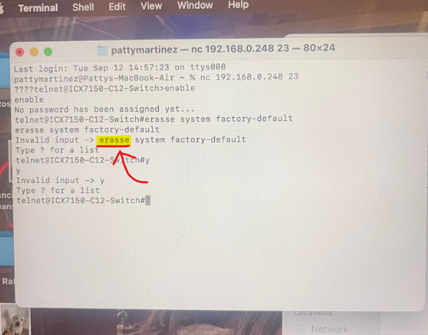

Hi @Patty
I see you have used an incorrect spelling for the command (Please refer to the below screenshot).
Please use the below commands once again and try.
erase system factory-default
y

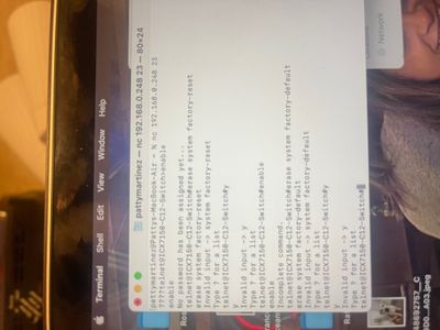

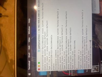

09-12-2023 03:13 PM
I updated new picture still no luck
