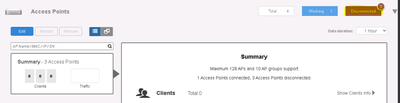

2:If you have access to the Unleashed APP or Dashboard web access, check the status of the affected access Point(off-line, getting an IP address or Software mismatch)
Example of a disconnected device:
Hit Access Point>
3:If it shows as disconnected, click on the access point to get more details and provide the screenshot.

I was at least able to login to the Ruckus Unleashed App and I can see that one of the access points is disconnected and thew other is online.
How do I get this back up and running?
