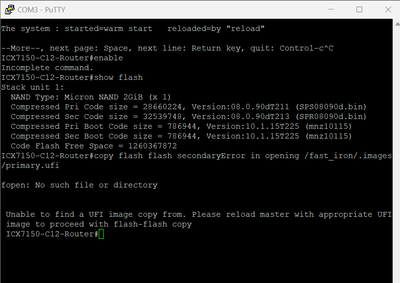

12-07-2022 04:26 PM
this is what happened when i went into putty consoled in to the switch and typed the commands, please help with what to try next, thank you

12-07-2022 04:40 PM
Please do this in the following sequence.
Don't add or remove anything.
copy flash flash secondary
write memory
Boot system flash primary yes

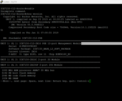

12-07-2022 04:43 PM
after i sent you the last screenshot, i went to your profile and followed the steps in "fix routing code" and i got it to show up as switch instead of router, so i feel like i made some progress?
on my ruckus app, it still shows up red, as icx7150-c12-router, so maybe i didn't make progress. i'll go follow your steps above now.
