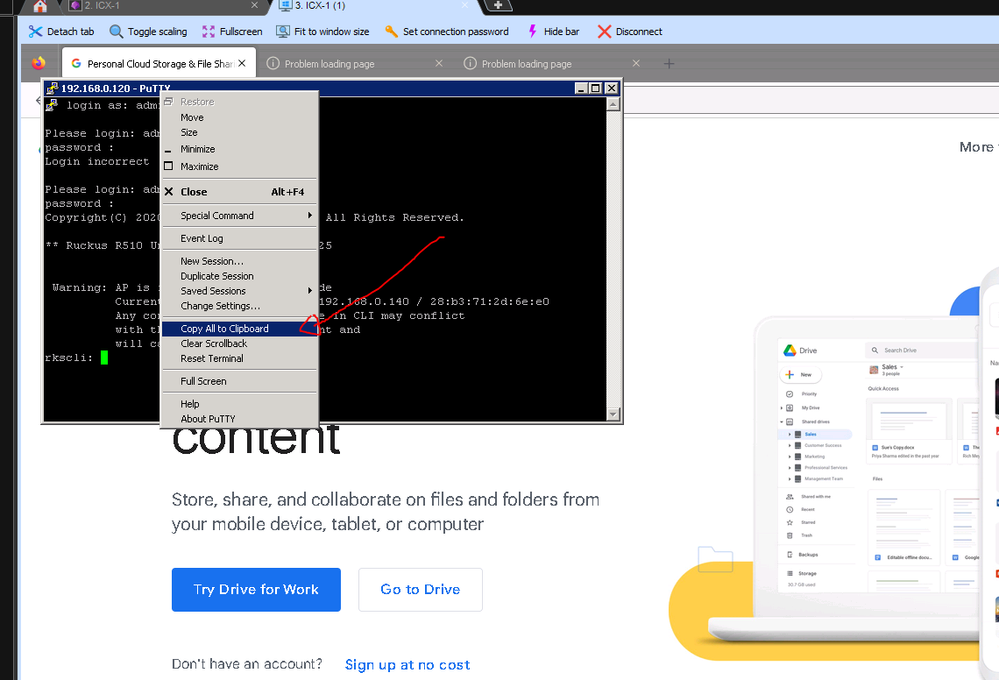

i have a lennar home, a ruckus switch, 2 APs, and for a week now, we have not been able to get a connection through the switch. lights are on on the APs, the network shows up but once connected, you're offline. it makes no sense. i have no idea what to do, ruckus will not help me, and i need my internet in order to get my job done. as another user said, the "instructions" provided here are way over my head, i think it's ridiculous that it's taking me this long to get the issue resolved, and i still see no end in sight. can anyone help me?

OKAY! it's rebooting. so it should work after this!? this is where your instructions ended.
12-06-2022 01:01 PM
also, is this concerning??
12-06-2022 01:02 PM
now it just keeps saying TFTP session timed out.
12-07-2022 04:43 AM - edited 12-07-2022 06:33 AM
Hi @relingburg
Hope you are doing well !
Could you please run a the following commands below and sent me the screenshot or copy and past it over chat
Show version
show flash
Show ip address
