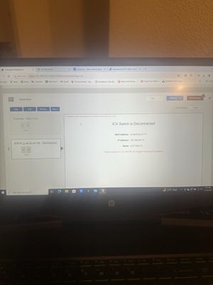

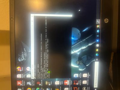

11-16-2023 07:43 PM
I have the same issue and tried to follow all of your instructions but none of my options look like what posted, nor do the same commands work. I have attached pictures of what it looks like for me on my end. Please help.
