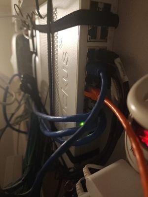

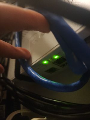

Hello.  I finally got both lights green-the power light is "steady green" and the system light is "blinking green".  The blue ethernet cord is plugged into one of the 12 ports on the Switch and the other end of the blue ethernet cord is plugged into port #4 on AT&T gateway.  Blue ethernet cord no longer in port #C1 on the Switch.   No light on port #4 on AT&T gateway.  Ports #1 & #2 have green lights in addition to the power port & ONT port on AT&T gateway.
The lights on the 3 APs are still off.
Is a 3rd light supposed to be green, "stat" on the switch??  If yes, mine is not.

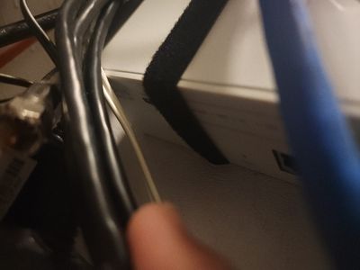

I'm attaching pics.
