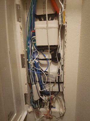

2. Regarding your ICX-7150-C12P Switch, when it is connected to the power outlet, do you observe any indicator lights illuminated (amber or green)? Please describe which lights are currently active. For further clarification, could you kindly share a photograph clearly showing the status of the lights and the full panel cable connections to the Switch ports, as illustrated in the screenshot example below?

Yes, Ruckus Switch and APs were operational. We had a Category 1 hurricane last week which knocked out the power.

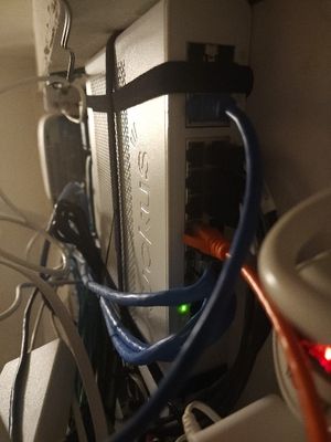

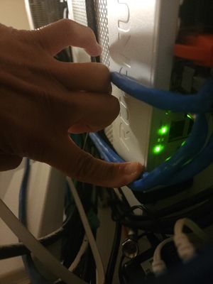

There are green lights on the Switch, one of which is blinking.

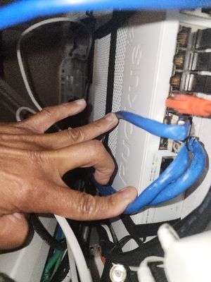

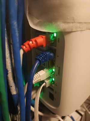

I am attaching pics per your request. I can only send one Pic at the time because of size. I'll send each Pic separately. There will be a total of 6 pics including the one attached to this response.

As per the light status of the RUCKUS ICX-7150-C12P Switch, it is in a normal state.
As I see from the picture you shared, seems like the ethernet cable which is coming from the ISP’s (Internet Service Provider’s) Router or Modem/Router combo is plugged into the wrong port on the Switch panel. It must be plugged into any 1 in-12 ports as shown in the below screenshot. Please unplug the ethernet cable, plug it into the correct port, and reboot (unplug and plug from the power outlet) your RUCKUS ICX-7150-C12P Switch and ISP Router once then try to connect to the Internet via Access Points.
