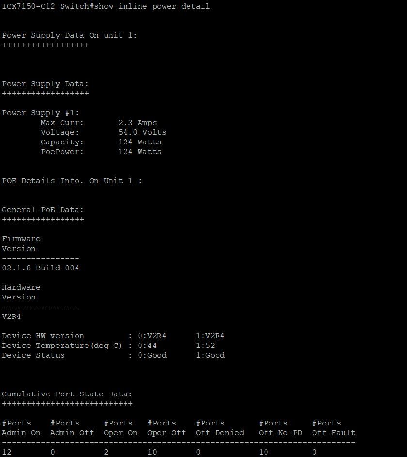

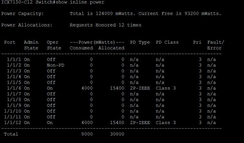

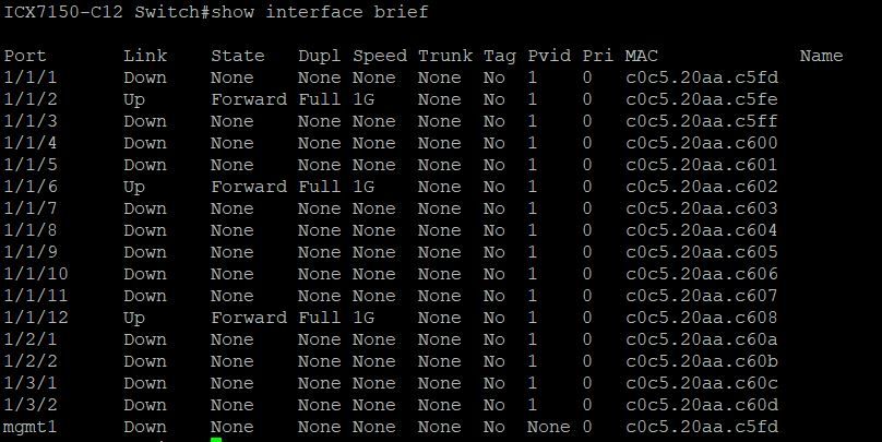

Here you go Pinky,

inline powerinline power

interface briefinterface brief
