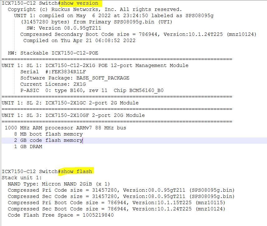

ICX7150-C12 Switch#show version
UNIT 1: compiled on May 6 2022 at 23:24:50 labeled as SPS08095g
(31457280 bytes) from Primary SPS08095g.bin (UFI)
SW: Version 08.0.95gT211
Compressed Secondary Boot Code size = 786944, Version:10.1.24T225 (mnz10124)
Compiled on Thu Apr 21 06:08:52 2022
HW: Stackable ICX7150-C12-POE
Serial #:FEK3834R1LF
Software Package: BASE_SOFT_PACKAGE
Current License: 2X1G
8 MB boot flash memory
2 GB code flash memory
1 GB DRAM
ICX7150-C12 Switch#show flash
Stack unit 1:
Compressed Pri Code size = 31457280, Version:08.0.95gT211 (SPS08095g.bin)
Compressed Sec Code size = 31457280, Version:08.0.95gT211 (SPS08095g.bin)
Compressed Pri Boot Code size = 786944, Version:10.1.15T225 (mnz10115)
Compressed Sec Boot Code size = 786944, Version:10.1.24T225 (mnz10124)
Code Flash Free Space = 1005219840

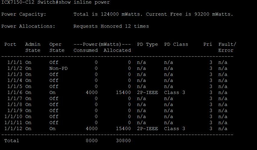

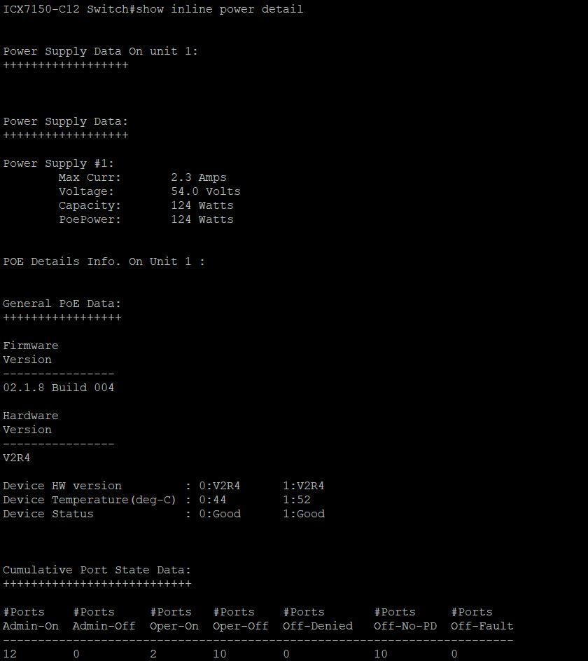

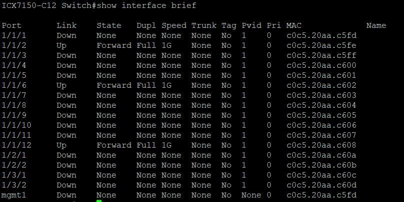

inline power
power details
interface brief
