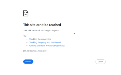

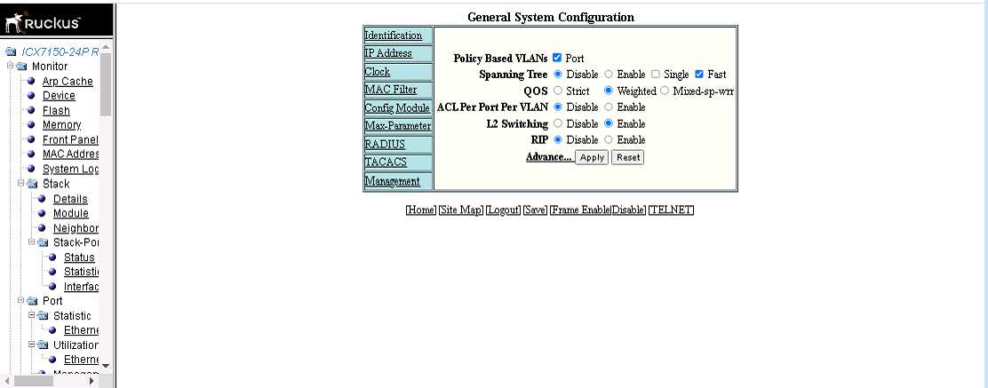

Please check IP Address 192.168.1.85 if that is related to the Switch.
You should see the Switch Dashboard in a web browser as shown in the below screenshot to confirm it’s a Switch IP Address.
01-07-2026 07:58 AM
This is what it says when i do that.
01-07-2026 07:59 AM - edited 01-07-2026 08:01 AM
wait it worked. im in. now i follow the other guide you sent?
