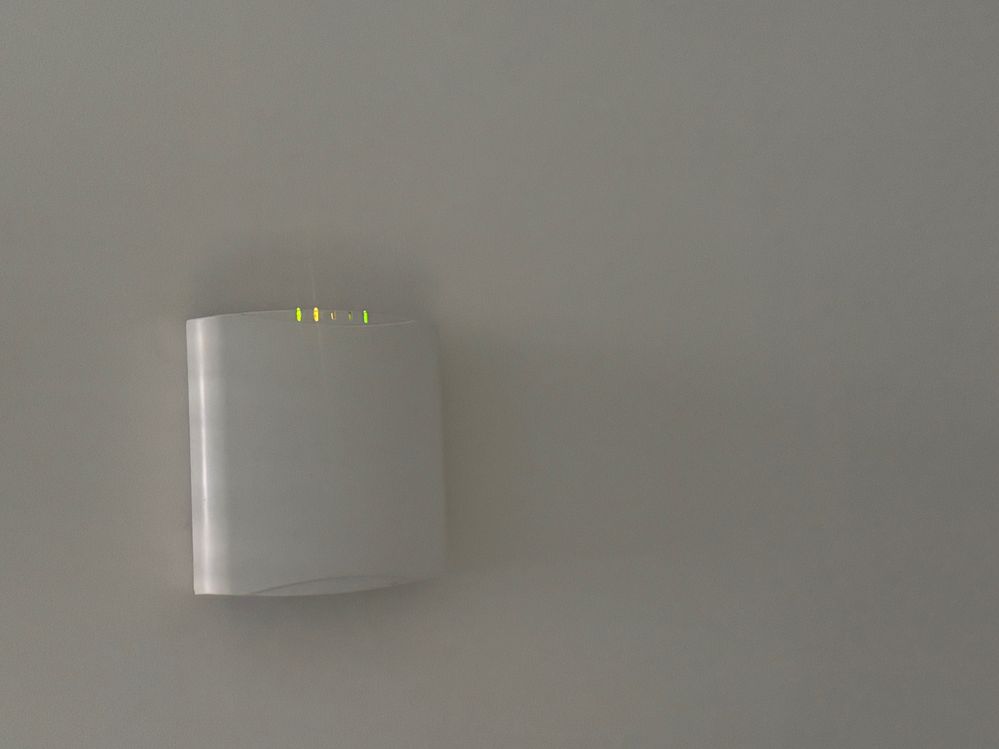

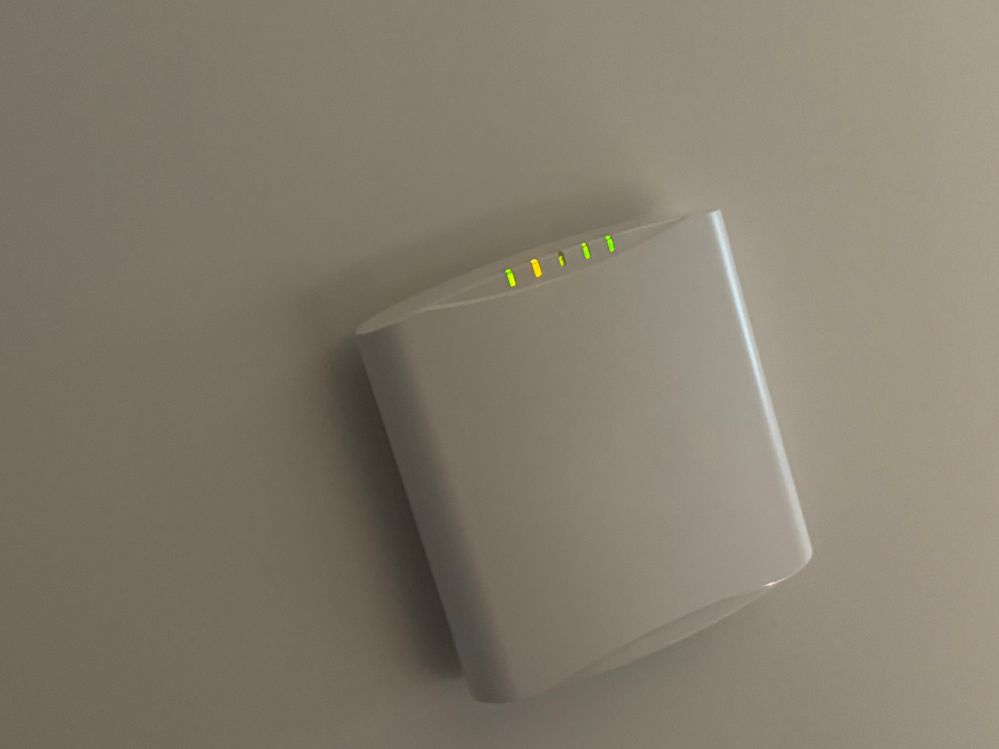

Hi! First off, I am not tech savvy whatsoever, but I am in need of help with my Ruckus WAPs. The issues are below.
1- Both WAPs are showing three green lights and one orange light. I have upgraded the software, rebooted, restarted the access points/switch but it is still the same.

Hi @cicibow1
I hope you can now connect to the Internet via RUCKUS devices without any issues or intermittent connectivity.
Amber/Yellow LEDs on the APs is a normal behavior.
Here is the meaning of each light on the Wireless Access Point so you can use it as reference.
Yellows light 2.4G: The radio is up, no clients are connected to the 2.4 GHz radio.
Yellows light 5G: Radio is up, no clients are connected to the 5 GHz radio.
So, if there is a device (iPhone) that is using the 5G radio, the light on the Access Point will be turning green on the 5G radio indicating that there is a client/device using that radio (5G)
I hope that makes it clear for you.

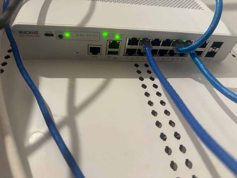

01-06-2026 01:07 PM
Here are my pictures
