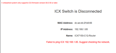

01-07-2026 06:49 AM - edited 01-07-2026 06:51 AM
it has powered back up and the lights on the AP is still the same and it still says its disconnected on the portal. Please see below message/screenshot.
01-07-2026 07:02 AM
Hi @cicibow1
If you see the IP Address of the RUCKUS Switch (Try IP Scan once again by rebooting the ISP Router once), please try to access CLI and share the command outputs. Please refer to one of our previous post for the process on accessing CLI and commands.
Let me know how it goes.
