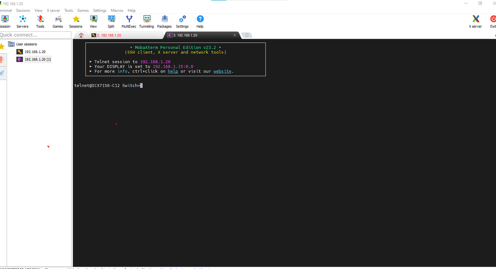

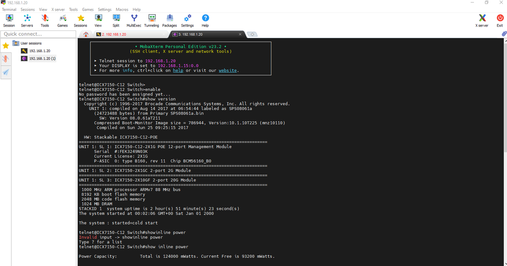

06-26-2023 01:36 PM - edited 06-26-2023 01:52 PM
Hello @Jayavidhya,
It looks like I was able to see the command by downloading MobaXterm. I hope this is what you were looking for, right?
06-26-2023 02:06 PM
Hi @bkpatel009
Thanks for your response.
Based on the images you have shared it seems that you PoE is in disabled state.
For powering up the access points we should enable the PoE . Once you are done with the process please upgrade the switch to the code 08095g, let me add the steps to enable back PoE and save the changes.
Switch>enable
Switch#configure terminal
Switch(config)#interface ethernet 1/1/7 to 1/1/12
Switch(config-mif-1/1/7-1/1/12)#inline power
Here are two options to perform the upgrade to the recommended code 08095, as you are running the old code, the upgrade must be done twice from where you are 08061 to 08080f then from 08080f to 08095 UFI, and you will always use the image that start with SPS.
