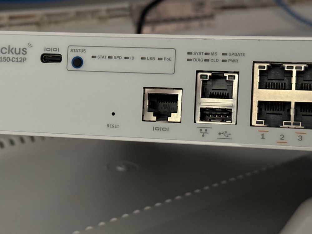

1. When your switch is connected to the outlet, do you observe any illuminated lights (amber or green)? Kindly describe which lights are visible. Additionally, please provide a photo showing the status of the lights and the full switch panel with cable connections to the switch ports.

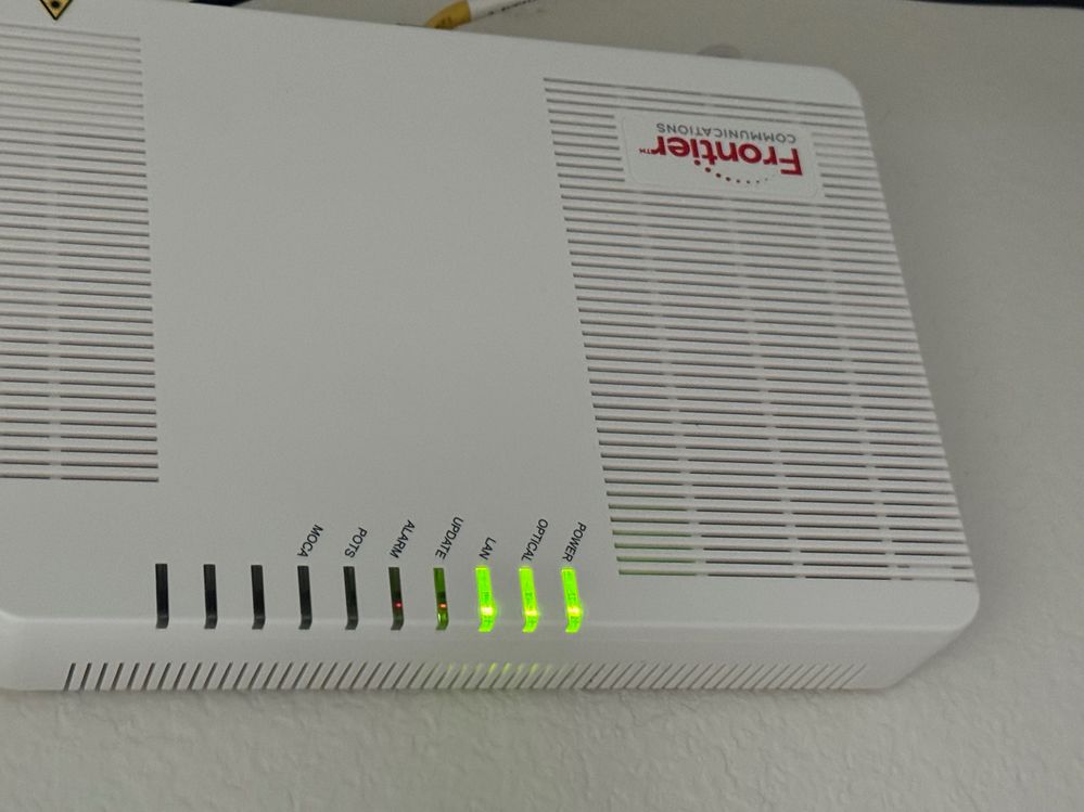

2. Is your internet connection from the ISP stable and functioning? You can verify this by connecting to your local router's Wi-Fi or through an ethernet cable from the router to a laptop/PC.

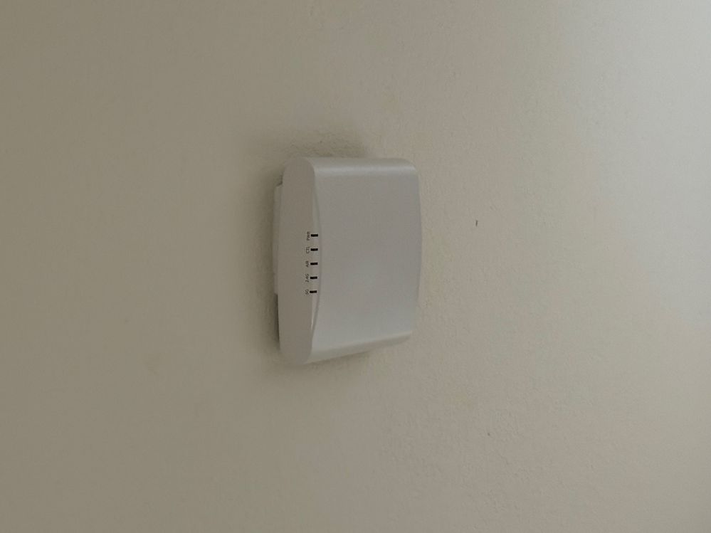

3. How many access points are currently connected to the switch? Please describe the status of the lights on the access points. Similarly, include a photo showing the access points' light status.
No lights illuminated (green or amber). This is the same on the ruckus ICX and the two extenders. No power. We have frontier  for our internet. We currently have internet directly through frontier router.
As stated above, our provider is Frontier and we are getting at this time a stable internet
we have 2 access points. No power and no lights on any of them
Hello @Jim82
Thank you for providing the information.
Based on the details you've shared, it appears that your RUCKUS ICX-7150-C12P Switch is not operational.
Could you please let me know if you tried to power it up using a different working power cord with different working power outlets? If no, please try it once.
If that doesn't work even with a working power cord, I recommend again attempting a physical factory reset multiple times, as outlined in our RUCKUS Lennar Knowledge Base self-help article accessible through this link and VIDEO:
https://community.ruckuswireless.com/t5/RUCKUS-Lennar-Support-Knowledge/Process-for-performing-a-phy...
If the initial reset attempts do not resolve the issue, please try resetting your switch multiple times (approximately 10-15 times) using the method described in the article. In some cases, repeated attempts have successfully resolved similar issues. Upon successful reset, the SYST and PWR lights should turn GREEN.
Please proceed with these steps and let me know if the switch powers on successfully afterward.
