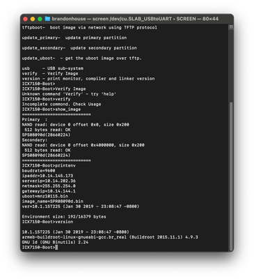

Hello, as of now I was able to get into the switch using my MAC via the Terminal.  Now I'm searching the forum for instructions on how to Perform a Software recovery using a MAC.
 This is what my Terminal shows.
Your Moderator sent me instruction for a PC however non of my PC's display a COM channel. So I switched over to my MAC to get into the switch.

Please make sure the console into the RUCKUS ICX-7150-C12P Switch first in a separate terminal screen prior to turning on the Mac internal TFTP server.
Perform the setenv commands and other processes after this that are mentioned in the guide. Refer the below screenshot and guide:
