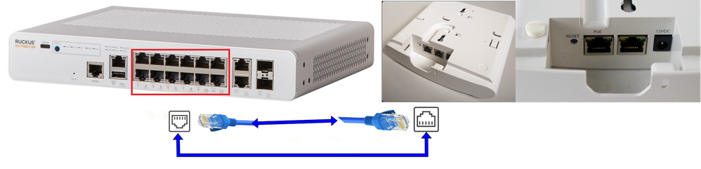

Hi @bigwavedave
Can do a Factory reset to one of the Access Points ?
To do this process you must disconnect all access points ( except 1 ) from the Switch and proceed to a factory reset with the only one that remained connected.
Once the Access point is Factory reset you can configured using the following guide
Ruckus Unleashed Set-up using your Mobile
