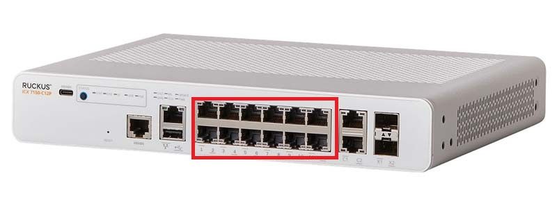

Hi @bigwavedave
Hope you are doing well !
Please make sure the devices are connected correctly , make sure that the cable from the Router to the Switch is connected in the right place " in 1 of the 12 ports " like below pictureICX-7150-C12P_appearance.jpg

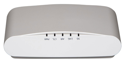

Quick question what are the color lights or status from the Access Points  ?

Power is flashing green
Ctl is steady green
No other lights are on
Hi @bigwavedave
Based on status of the lights seems to be that the Access points are no connecting to the Local router Router ISP.
Please check the following guide:
In order to make sure that the Router cable is plugged in , in the right place
Best Regards

The AP keeps popping up randomly as recover.me248C50 (the serial #) but then disappears. The couple of times I have tried to put in a password (the serial number) I get the message "Can not join network"
