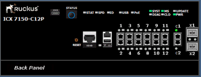

What lights specifically are you looking for? Web UI shows this: Ports 1 & 2 are connected to the APs and are not lit. Ethernet from router is in uplink C1

I confirmed, ports 1 and 2 are R320 POE APs. Port 12 is eth to router.
According to install guide "RUCKUS LED Lights" from previous post they are as follows:
  1. Port status mode selection button
  2. Port link status mode LED (green when selected)
  3. Port speed status mode LED (green when selected)
  4. Member ID status mode LED (green when selected)
  5. USB status mode LED (amber when selected)
  6. PoE status mode LED (green when selected)
  7. System Status LED (green)
  8. Master/Slave status LED (unlit)
  9. Software update status LED (unlit)
  10. RJ-45 port 5 RX/TX activity LED (if blinking indicates RX/TX activity) (unlit)
  11. PoE LED (unlit)
  12. RJ-45 uplink port C1 status LED (unlit)
  13. RJ-45 uplink port C1 RX/TX activity LED (unlit)
  14. SFP+ uplink port X1 status LED (if blinking indicates RX/TX activity) (green, not blinking)
  15. SFP+ uplink port X2 status LED (if blinking indicates RX/TX activity) (green, not blinking)
  16. Power status LED (green)
  17. Cloud/On-premise-SmartZone management status LED (unlit)
  18. Diagnostics status LED (unlit)
