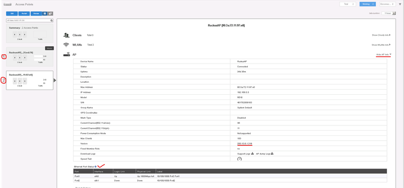

And could you please share screenshots of both APโ€™s information from the Unleashed as shown in the below screenshot as a example.
