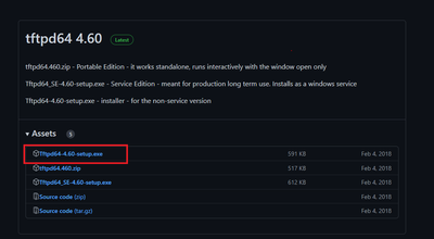

I'm following the second option to upgrade my switch but I cannot get access to this download:
https://github.com/peacepenguin/tftpd64/releases
I clicked on the link and it tells me page not found and it is not the webpage I'm looking for.  So it seems I'm stuck at this step.
Hello @JasonO13
Thank you for your prompt response and the update.
Please utilize the alternate link provided within the same guide. Here is the link for your convenience: https://bitbucket.org/phjounin/tftpd64/downloads/
Kindly inform me if you require any further assistance during the process.
