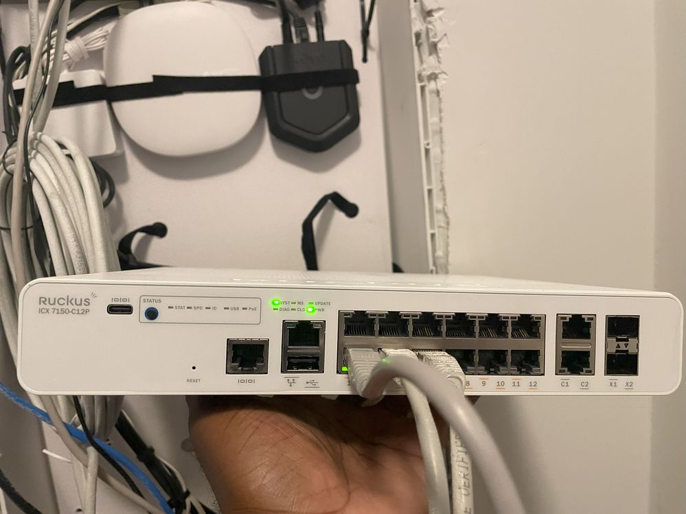

  2. On your switch while it's plugged into the outlet, do you see any lights on? (Amber or green) Please let us know which lights are on. (Please refer to the below picture and share a picture of the same, showing the light status and the FULL Switch panel cable connections to the Switch ports)

There was a thunderstorm while we were away from the house around the end of June 2024. When we returned the APs were not working. The switch has lights on when plugged into the outlet. I've attached a picture showing the lights. There are 3 cables connected to the switch. The first cable runs from the router to the switch. That port has a green light. The 2 other cables runs from the 2 APs to the switch. Those ports don't have lights.

From the pictures you shared, the lights on the Switch is normal and switch is working and there are no lights in the access points, it is always good to check if the PoE is disabled or not.

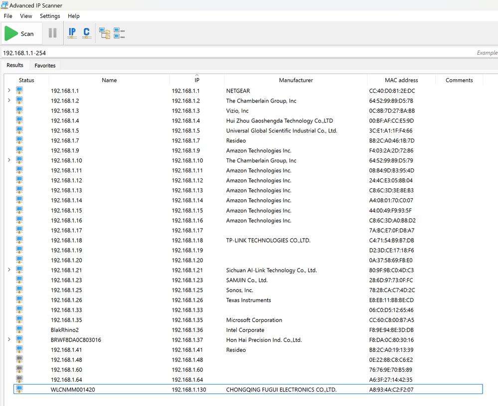

I am unable to find the IP address for my switch using the IP scanner software. My switch's MAC address is 78:A6:E1:3E:48:E8 and I don't see it in the below screen shot:
