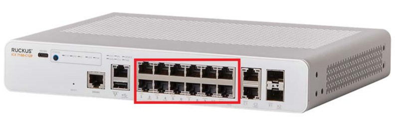

1. Regarding the two ethernet cables coming from the R510 APs - what ports on the switch do I plug them into?
- We have to plug these Two ethernet cables coming from APs into any Two ports in 12 ports on the ICX-7150-C12P Switch. (Please refer to the below picture).
2. I do not know which cable comes from the Master AP, and which comes from the slave AP if that makes a difference.
- It doesn’t make any difference, only to note here is, it has to be plugged into any of those 12 ports as described above in the 1st Answer.

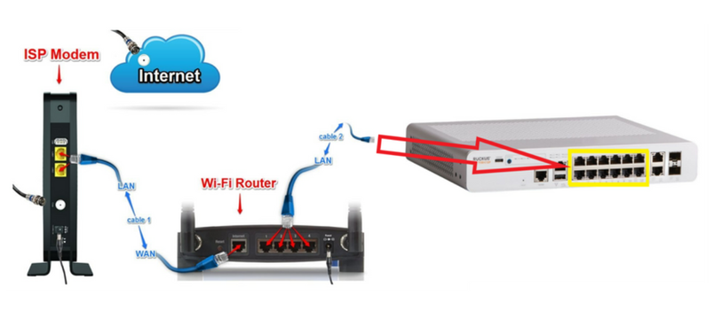

4. The ethernet cable coming from the ISP - what port on the switch do I plug that into? Also - can I connect an ethernet cable coming directly from the modem to the 7150 switch, OR, am I required to install a router between the modem and the switch? 3/ if a router is not required, can I connect an ethernet cable from the modem to a TPLink 5 port switch, and then an ethernet cable from the TPLink 5 port switch to the ICX 7150 switch, and again, to which port?
- The ethernet cable coming from ISP also should be plugged into any one of the 12 ports as shown in the picture above.
-No, you cannot connect the ethernet cable to the Switch directly from the Modem (Please refer to the below picture). There has to be a Router along with a modem or it also can be a Modem-Router combo device. Since the routing process is carried out by a router and DHCP is enabled to the router to assign an IP Address to any connecting device.
-No, you cannot connect a TP-Link Switch to ICX-7150-C12P Switch.
