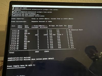

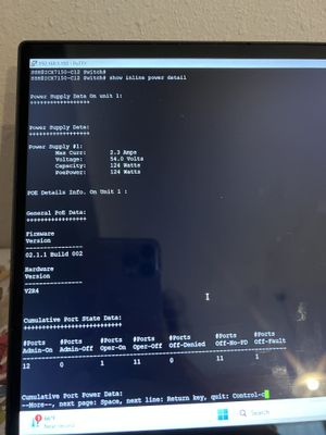

My daughter Dar, was able to follow the step you told is to do byt what is next? We are also unable to upload the pictures of what we did…"in line power detail"

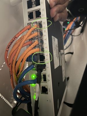

Which port did you relocate the cable from port #4 to? Is the issue still happening?
Could you please take a picture of the cables connected to the switch (white box on the cabinet) and share it with me??
Dar
It was relocated from port #4 to port #12. It's still not working. Also, the unit/receiver on the ceiling doesn't have any lights

1. I've observed that the PoE device on Port #1 is operational and receiving power, as indicated by the logs showing it as ON. Would you kindly transfer the cable from port #12 to port #1, and then share the outcome with me?
-I'm contemplating whether the issue might be more related to the cables themselves, rather than being associated with the Ruckus switch.
