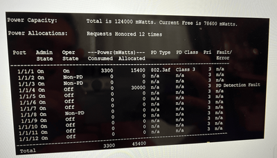

hi @Dar
Would you kindly relocate the cable from port #4 to any available empty port?

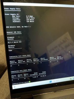

What was the result? After relocating the cable could you please share with me again the commands show inline power and show inline power detail?

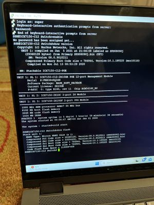

Additionally, please access the CLI, and execute the following commands and provide the resulting output:
(Note: Press Enter after each command)
ICX7150-C12 Switch>enable
ICX7150-C12 Switch#show version
ICX7150-C12 Switch#show flash
Copy and paste the results on the chat (here)

10-12-2023 07:25 PM
10-13-2023 06:21 AM

10-14-2023 05:36 PM
Here's the new results after relocating the cable from port #4
