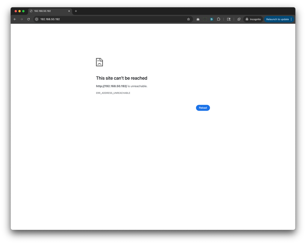

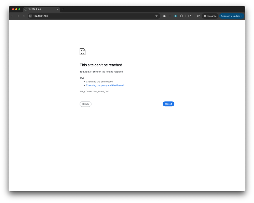

09-09-2025 07:42 AM
Hello,
Here are the screens you requested again. They are still not connecting like earlier screen shots.
