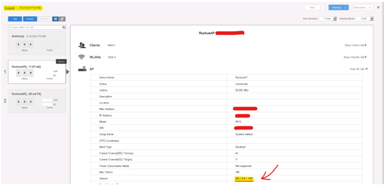

Please check the current version of your Unleashed Access Points and share a screenshot of the same.
Please refer to the below screenshot for more information on how to know your Unleashed Access Points version details.

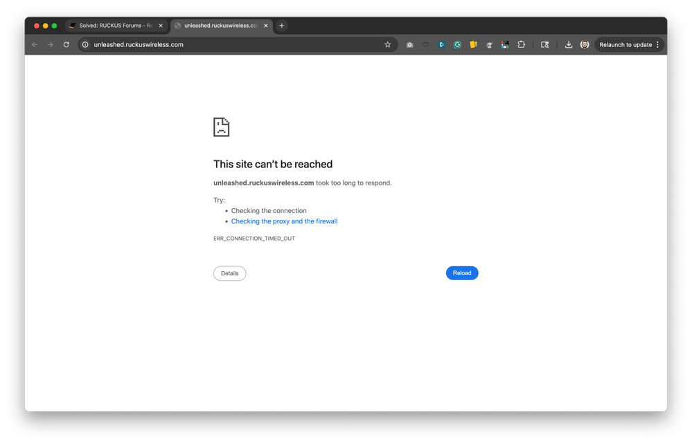

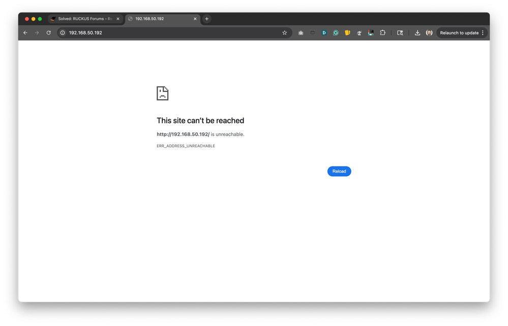

09-02-2025 08:17 AM
Here are the screen shots of the URL and IP address when conneced to the ruckus wifi

Hello,
Could you please share the screenshot of the IP address scan results?
I recommend cross-checking the IP addresses listed in the IP scan results under the names "Ruckus Wireless" or "Brocade Communications" to identify the correct IP address of the Unleashed Access points.
