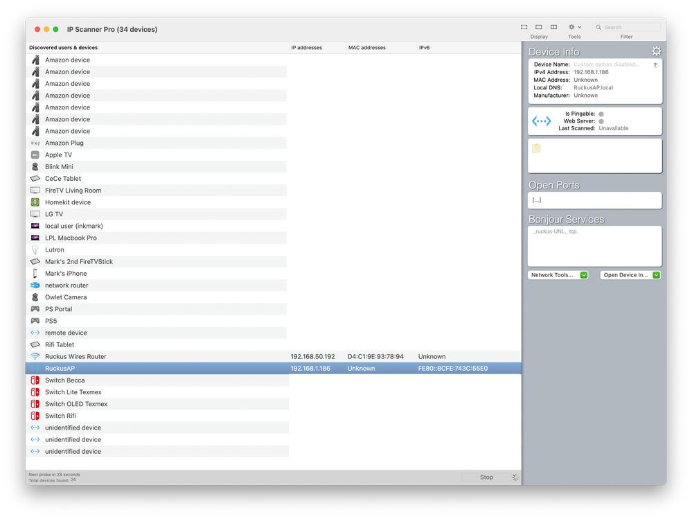

I only included the screen shot for one of the IP's but i get the same message for both IP's
pinky_ruckus
Valued Contributor III
Hello,
I understand that you are getting error for both the IP addresses.

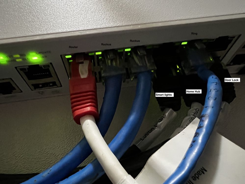

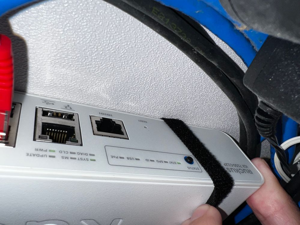

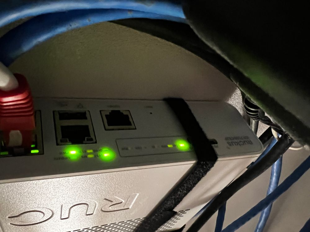

Please refer to the below picture and share a picture of the same, showing the light status and the FULL Switch panel cable connections to the Switch ports)
Hello,
Here are the photos. I've attached two photos of the lights; it is upside down, and it's hard to see the lights and text in just one photo. I used flash, which washed out the lights.  I also added text for what is connected. Everything that is connected is currently working. Let me know if you need anything else. Connections.jpegPanel-Flash.jpegPanel Lights.jpeg
