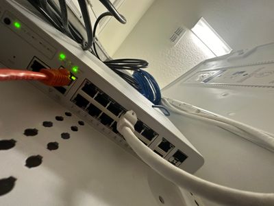

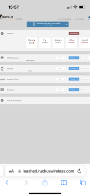

Adding some photos and screen shots, the orange cable is the internet input, white one is one of the AP.
In the dashboard, it shows no internet.
I tried factory reset the switch, doesn't work. The internet in my home is good. I don't know why here says no internet

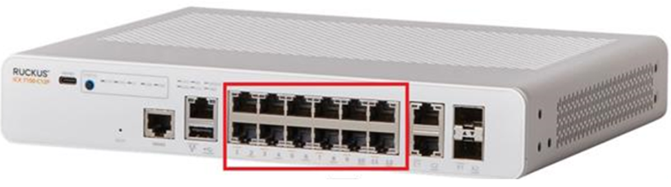

Hello @zsl666 ,
As per the description, I understand that your Ruckus setup is not working.
From the screenshot you shared, it seems like the ethernet cable which is coming from the ISP’s (Internet Service Provider’s) Router or Modem/Router combo is plugged into the wrong port on the Switch panel.
It must be plugged into any 1 in-12 ports as shown in the below screenshot.
Please unplug the ethernet cable and plug it into the correct port then reboot (unplug and plug from the power outlet) and try to connect to the Internet via Access Points.

Hello @zsl666 ,
Could you please confirm if you have connected the Ethernet cable to one of the 12 ports on the Switch?
