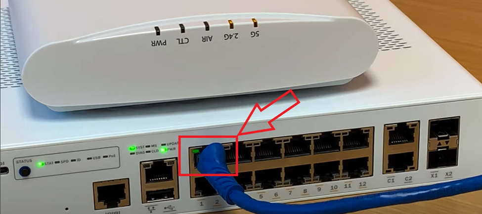

Please check the cables from the Wireless access Point on the switch ICX-7150-C12.
Indicate what color (green or amber) is the port that goes to the access points

Mymnte
New Contributor III
They are all green
