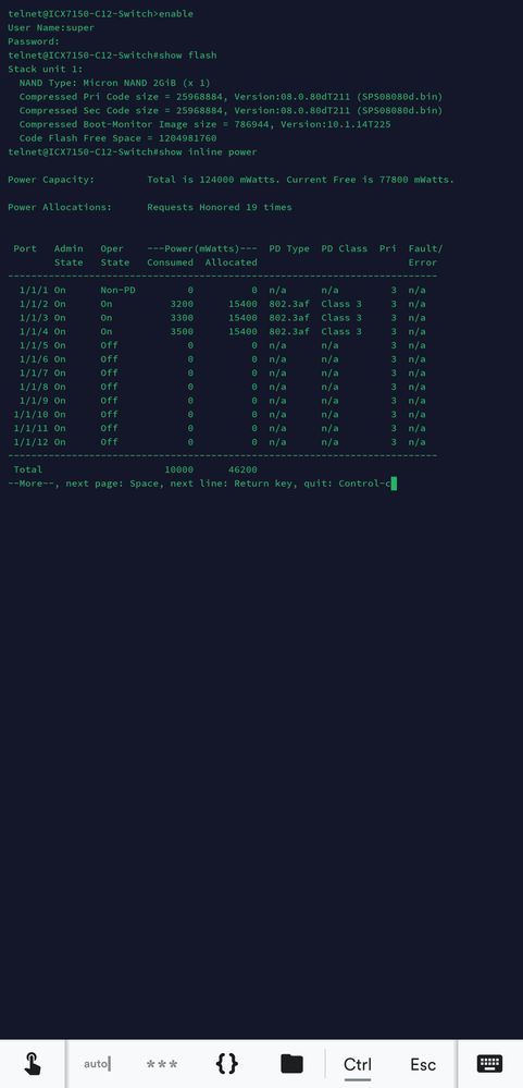

01-12-2023 08:47 AM
Hi @Mymnte
Hope you are doing well !
Please once you are on SSH on the switch run the following commands
-Enable
-Show flash
-Show inline power
Best Regards
Fernando Vasquez
01-12-2023 09:27 AM
