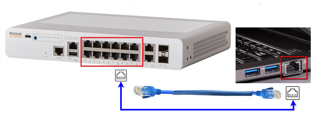

Hi @Mymnte
1-Can you check if this is happening on the ISP local ( router ) ?
2- Is this happening on a specific Access Point ?
3- Please make sure that wired is ok.
4- Please connect a PC directly to the Ruckus Switch ICX-7150 to see if you are having the same connectivity issue
Best Regards
Fernando Vasquez
