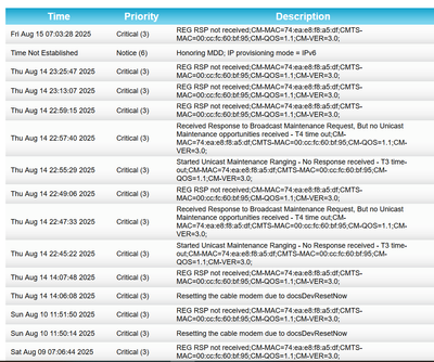

I'm still having the issue after my last modifications. Any next steps you can suggest would be greatly appreciated.
Here is my modem's event log:

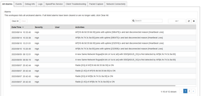

And here is the Unleashed event log:

The issue I’m having is not with speed of internet. It’s with completely losing internet connection all together. I thought you were aware that this was the issue as we’ve discussed repeatedly over the past several weeks.
I had Xfinity (ISP) out to the house yesterday and he didn’t find any issues with wiring to the modem; however, I did purchase a new modem just to be sure and will be installing it this evening after work. I’ll let you know whether it solves the issue. If not, the only other culprit is the ICX switch or the APs.
