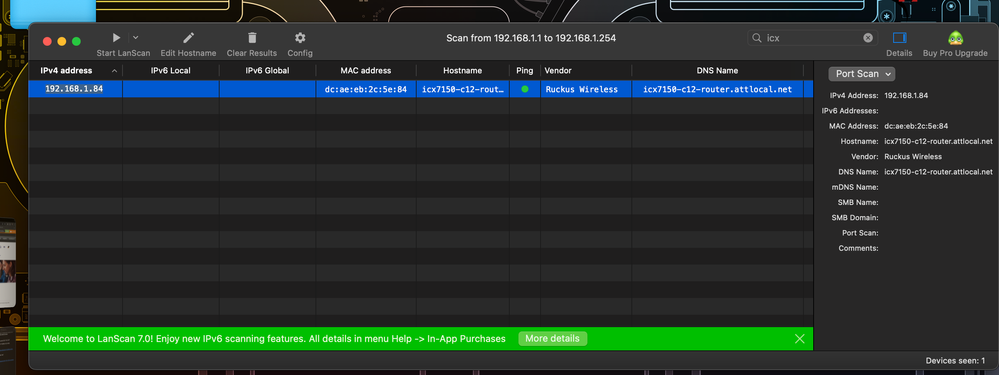

As per the screenshot you shared, your Switch has a primary partition on SPS as highlighted in the below screenshot.
Please follow the process once again as per the link shared previously to bring your partition to the primary which is on SPS Code. (Also, sharing it below once again)
https://community.ruckuswireless.com/t5/RUCKUS-Support-for-Lennar-Homes/How-to-Fix-Routing-code-issu...
Step-by-step screenshots below:

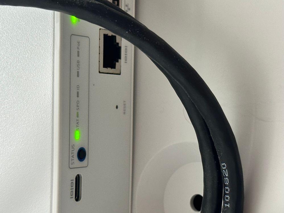

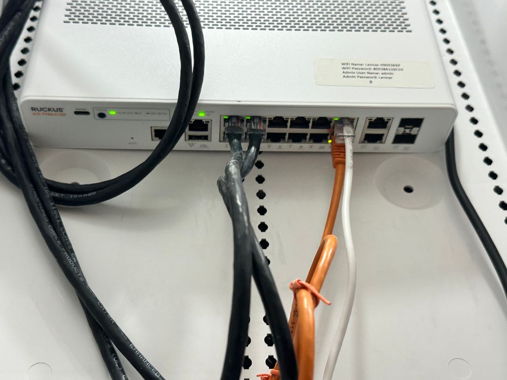

1. On your switch while it's plugged into the outlet, do you see any lights on? (Amber or green) Please let us know which lights are on. (Please refer to the below picture and share a picture of the same showing the light status and port connections)
2. Is your Internet Connection from the Internet Service Provider (ISP) stable and working? (You could check this by connecting to your local router Wi-Fi or from an ethernet cable from Router to a laptop/PC)

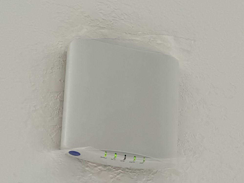

3. May I know how many Access Points are connected to the Switch? Could you please let me know the light status on the Access Points? Any of these lights are on (Please refer to the below picture and share a picture of the same)
Please help us with pictures of your ICX-7150-C12P Switch showing the status of the lights. Also, light the status of Access Points.
Please let us know the answers to the above queries or if you have any queries in this regard.
Hello i have 2 access points. here are the pictures..
Hi @SIBAZZ
This issue may happen when the Switch runs on the Routing code (SPR). The Switch should run on the Switching code (SPS) to avoid these issues for Lennar home users. If the Switch boots up on the other partition (Due to a power outage/power spike) which may be running on a ‘Routing Code’ results in causing this issue. To check the same please follow the below process.
ICX7150-C12 Router> OR
ICX7150-C12 Switch>
show version
show flash
