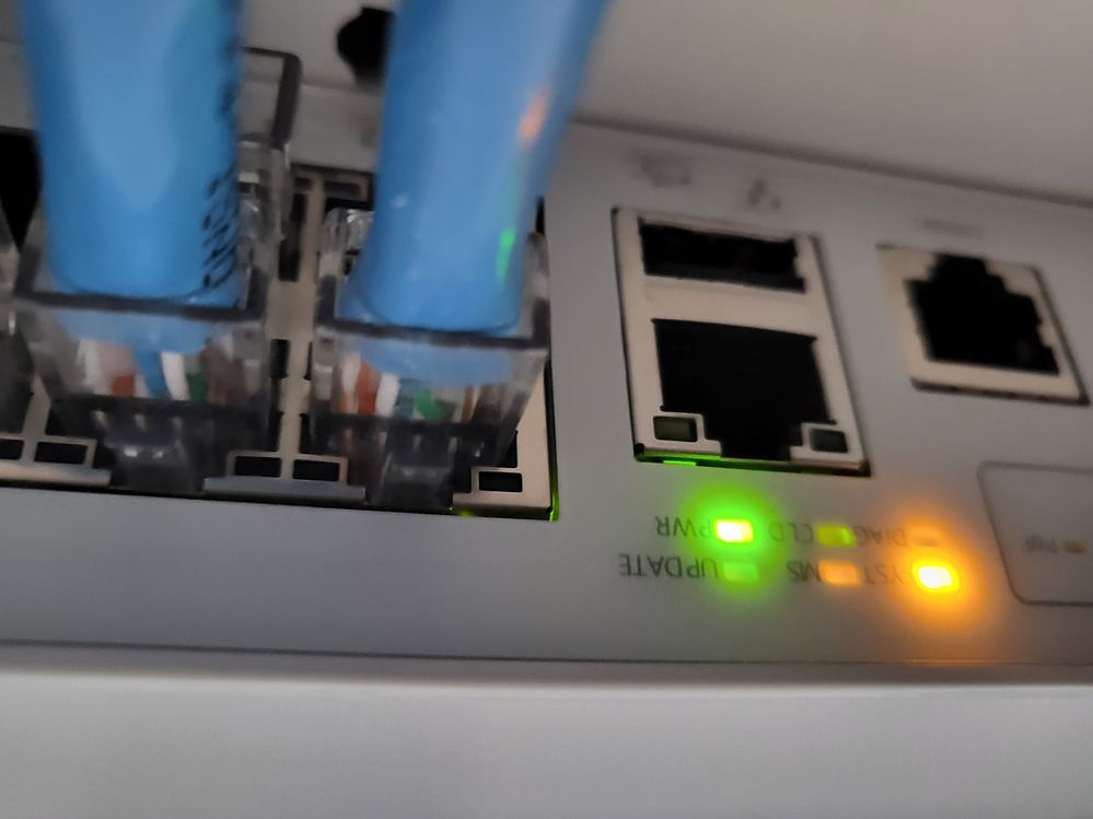

1. On your switch while it's plugged into the outlet, do you see any lights on? (Amber or green) Please let us know which lights are on. (Please refer to the below picture and share a picture of the same)

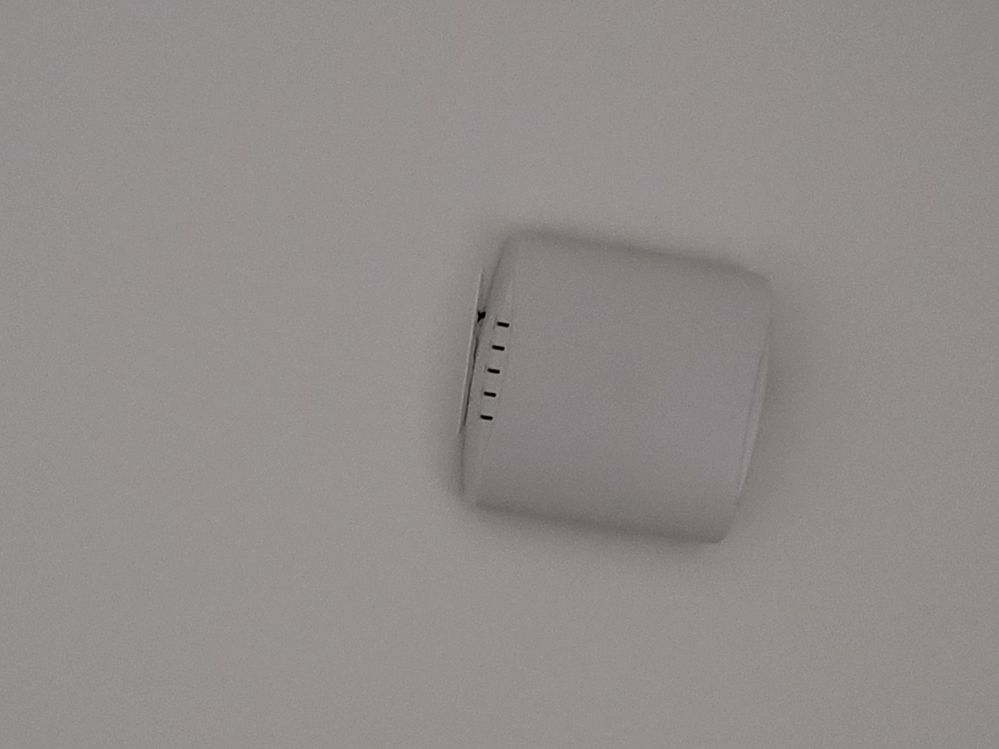

2. May I know how many Access Points are connected to the Switch? Could you please let me know the light status on the Access Points? Any of these lights are on (Please refer to the below picture and share a picture of the same)
Please help us with pictures of your ICX-7150-C12P Switch showing the status of the lights. Also, light the status of Access Points.

PWR light is Green
SYST light is Amber
All Access points lights are off including power also.
May I know how many Access Points are connected to the Switch? - Three access points
Access Points (all lights are off)Access Points (all lights are off)Rucks Switch (SYST Amber)Rucks Switch (SYST Amber)

As you mentioned and we can see from the screenshot you shared, there is an amber/orange light on the "SYST" and a green light on the "PWR" on the Switch. Meaning the Switch is stuck in the boot mode.
Basically, due to the power outage/ power spike, the switch went to a state that we call ‘boot mode’ that is not able to boot up properly.
