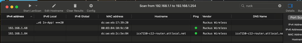

05-01-2023 04:57 PM
okay i found it.. however the other program is windows only i have a macbook
im stuck here on part 2
ICX7150-C12 Router> OR
ICX7150-C12 Switch>

05-02-2023 08:11 AM
Hi @SIBAZZ
As you are trying to log in with a Switch IP address, you should see the Switch Dashboard as shown in the below screenshot to confirm it’s a Switch IP Address.
To confirm the Switch IP address, try to access your switch from a web browser by pasting the below URL in http or https form whichever that works.
Once you confirm the Switch IP Address, please try to access the CLI as mentioned in the other guide from the last post and help us with the command outputs. (Sharing the CLI access guide once again below). There is also an explanation for accessing CLI on Apple MAC devices.

05-02-2023 08:19 AM
Yes I was able to get to there but what is the credenciales because it’s asking for a login
