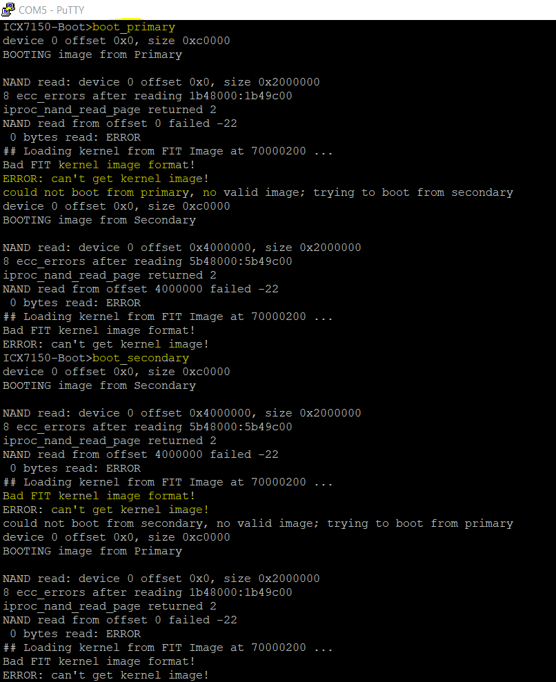

Based on the troubleshooting done, you confirmed, and we saw that after the reset, booting up the Switch, and trying the software recovery process, the failure persists. This Switch unit Should be RMA (Return Merchandise Authorization) in simple words replacing it.

1. Tried boot_primary or boot_secondary.getting ERROR: can't get kernel image!

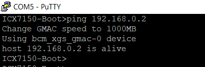

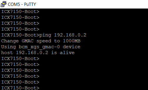

i am getting host 192.168.0.2 is alive

3. and while boot_primary or boot_secondary
Bad FIT kernel image format! ERROR: can't get kernel image!'
