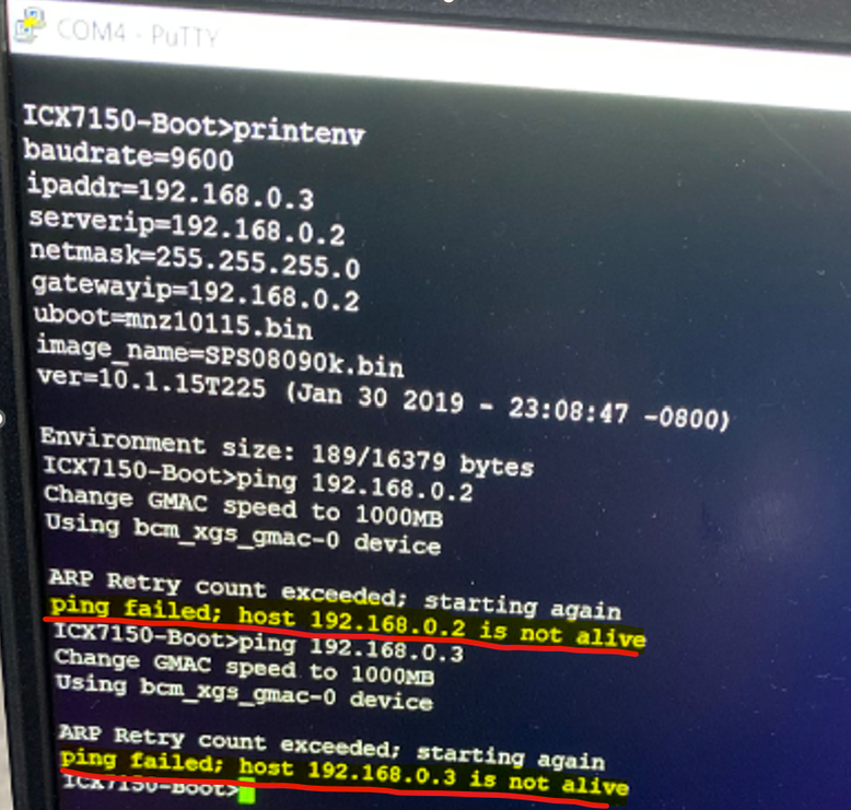

During Software Recovery, some users encounter the error:
'ping failed; host 192.168.0.x is not alive'
This article explains why this error happens and provides step-by-step instructions to resolve it so that the Software Recovery can be completed successfully.
This error usually occurs when the Firewall on your Laptop/PC is enabled while attempting Software Recovery. The firewall blocks communication between your computer and the Switch, which prevents the recovery process from continuing.
In Figure 1, you can see the highlighted error message:
FIGURE 1: “ping failed; host 192.168.0.x is not alive” error

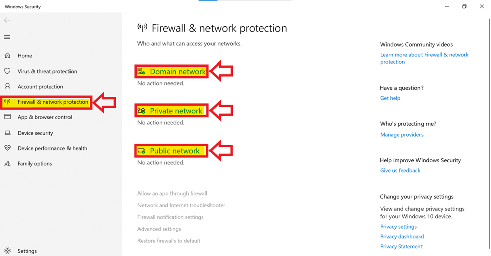

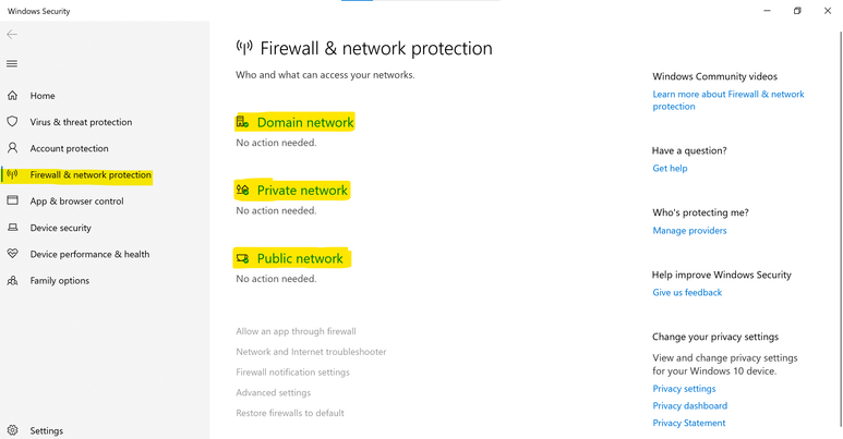

1. Refer to this link Windows Security Settings on your PC.
2. Navigate to Firewall & Network Protection.
3. Turn OFF the Firewall for all profiles:
FIGURE 2: Firewall & Network Protection Settings
Important: Ensure the firewall is turned off for all profiles before proceeding.
4. Close PuTTY (or whichever terminal program you are using).
5. Restart PuTTY and begin the Software Recovery process again, starting from the setenv IP configuration step in the official recovery guide.

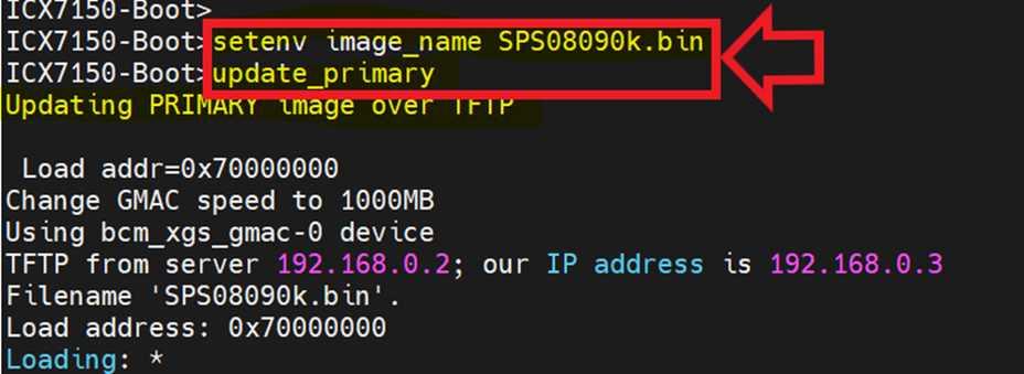

Load Image into Primary Partition:
setenv image_name SPS08090k.bin
update_primary
(Replace SPS08090k.bin with the correct image filename you are using)
FIGURE 3: Primary Image Update Command

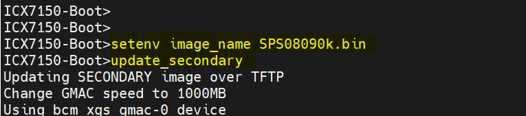

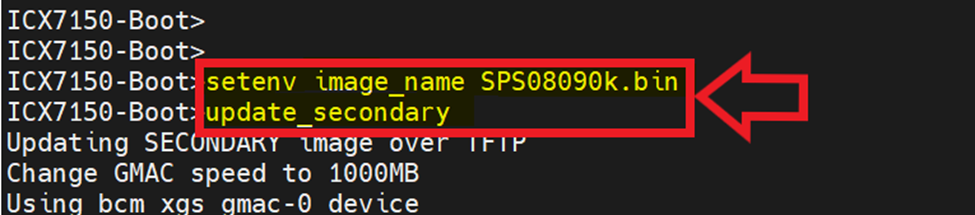

Load Image into Secondary Partition:
update_secondary
FIGURE 4: Secondary Image Update Command

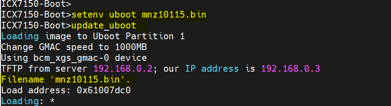

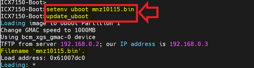

Load Boot Code
setenv uboot mnz10115.bin
update_uboot
(Replace mnz10115.bin with the correct boot file name provided in your recovery package)
FIGURE 5: Boot Code Update Command

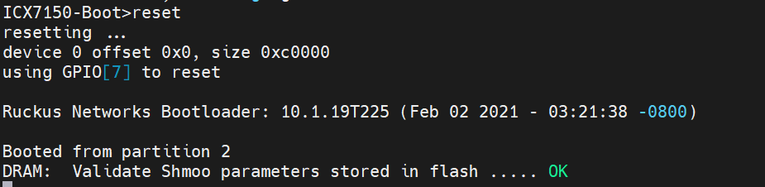

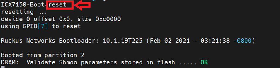

Final Reset Command
reset
This will reload the unit and complete the recovery process.
FIGURE 6: Final Reset Command
