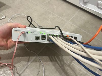

04-22-2023 05:03 AM
Same issue for me. Here is what my switch currently looks like. Please help.

As you mentioned, and we can see from the picture you shared there is an amber/orange light on the "SYST" and a green light on the "PWR" on the Switch. Meaning the Switch is stuck in the boot mode.
Basically, due to the power outage/ power spike, the switch went to a state that we call ‘boot mode’ that is not able to boot up properly.
We suggest upgrading your switch to the latest stable version to avoid this issue in the future. Please let us know once you complete the below process to assist you with the Upgrade of the Switch.
