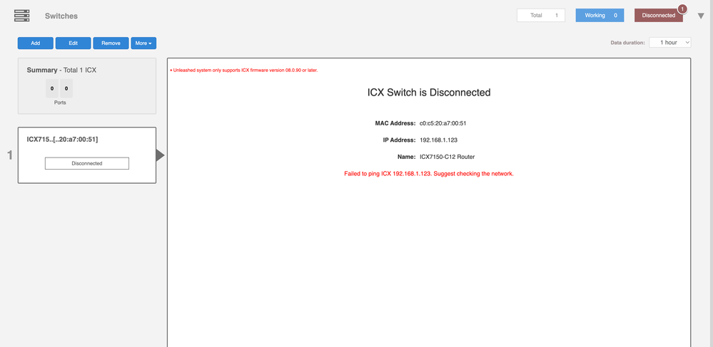

His switcher gives an error message that states "Failed to ping ICX 192.168.1.123, Suggest checking the network." I also realized (from searching these forums) that the name of his switcher is ICX7150-C12 Router, which is not a good thing, its in router mode.

I agree with you that I believe this to be a "router" issue as the dashboard image matches your screenshot above.

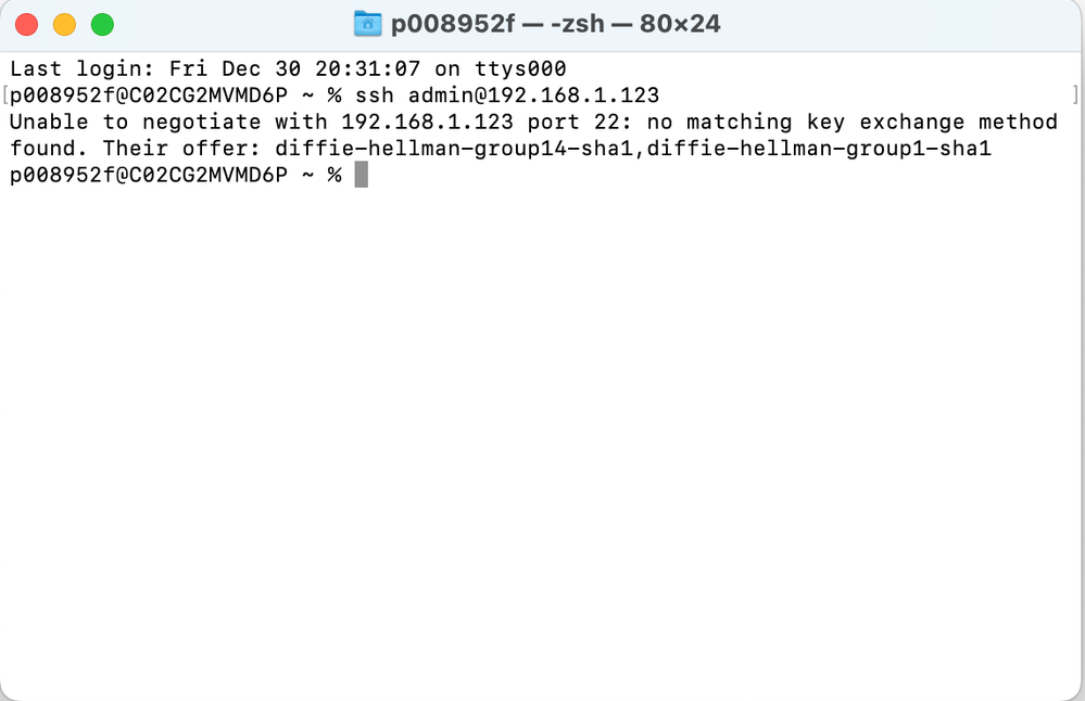

I tried the 2nd option using the SSH Access -
No connection established. See the following screenshot with my Terminal code.

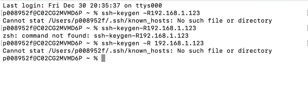

Then I tried the final step - "if access to ssh does not work tried the following ssh-keygen -R 'ip address of the device' this generates a public key pair for use when authenticating with a remote server."
No connection established. See my screenshot for the Terminal code.
Am I entering the wrong things into the Terminal? Why can't my laptop establish a connection with the Switcher via hardline? I can connect via the Web option.

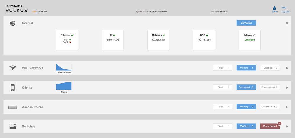

After the Switch and APs restarted, I am still getting this on my main dashboard.
When I went back into the Web GUI, the boot sequence menu still had the switcher loading from primary flash
