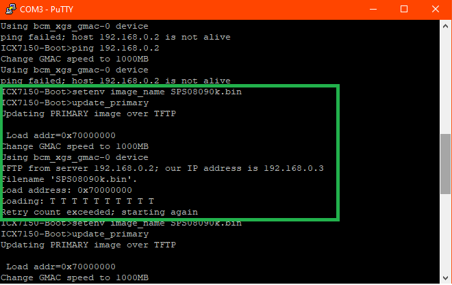

Even after turning off the firewall if you see the same error. Please perform the next commands after this step you see in the below ‘not alive’ error.
ICX7150-Boot>ping 192.168.0.2
Change GMAC speed to 1000MB
Using bcm_xgs_gmac-0 device
ping failed; host 192.168.0.2 is not alive
Please perform the below commands:
“setenv image_name SPS08090k.bin” (enter the correct image file name)
“update_primary” (upload the image on the primary partition)
“update_secondary” (upload the image on the secondary partition)
*Wait that loads the image and continue with the boot:
“setenv uboot mnz10115.bin” (enter the correct boot file name)
“update_uboot” (upload the boot code)
* Wait that loads the boot and continue with the Final command reset:
“reset” (finally enter reset to reload the unit)
After performing the above commands please check if PWR and SYST lights on the Switch turns GREEN, meaning it is back to normal and let me know if you have any queries in this regard.
09-21-2023 05:30 PM
Imran, I didn't get far this time. There was a timeout error as seen below after I named the file (I verified its the right file) and tried to update the primary.
