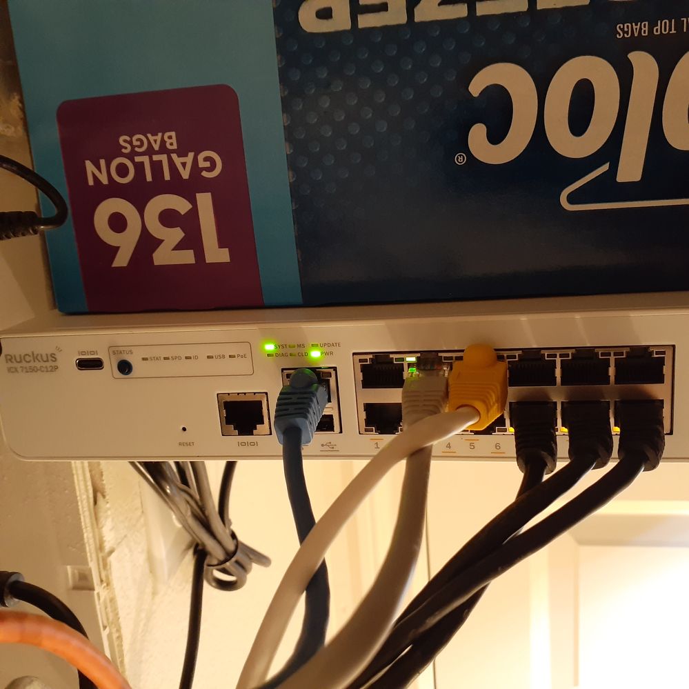

c319917
New Contributor III
I tried the hard reset, here is the picture of the lights after the reset, noted that the status lights are not on.
Thank you very much.
Hi @c319917
Thank you for your response and the information provided.
Based on the picture you shared, the status of your RUCKUS ICX-7150-C12P Switch appears to be normal.

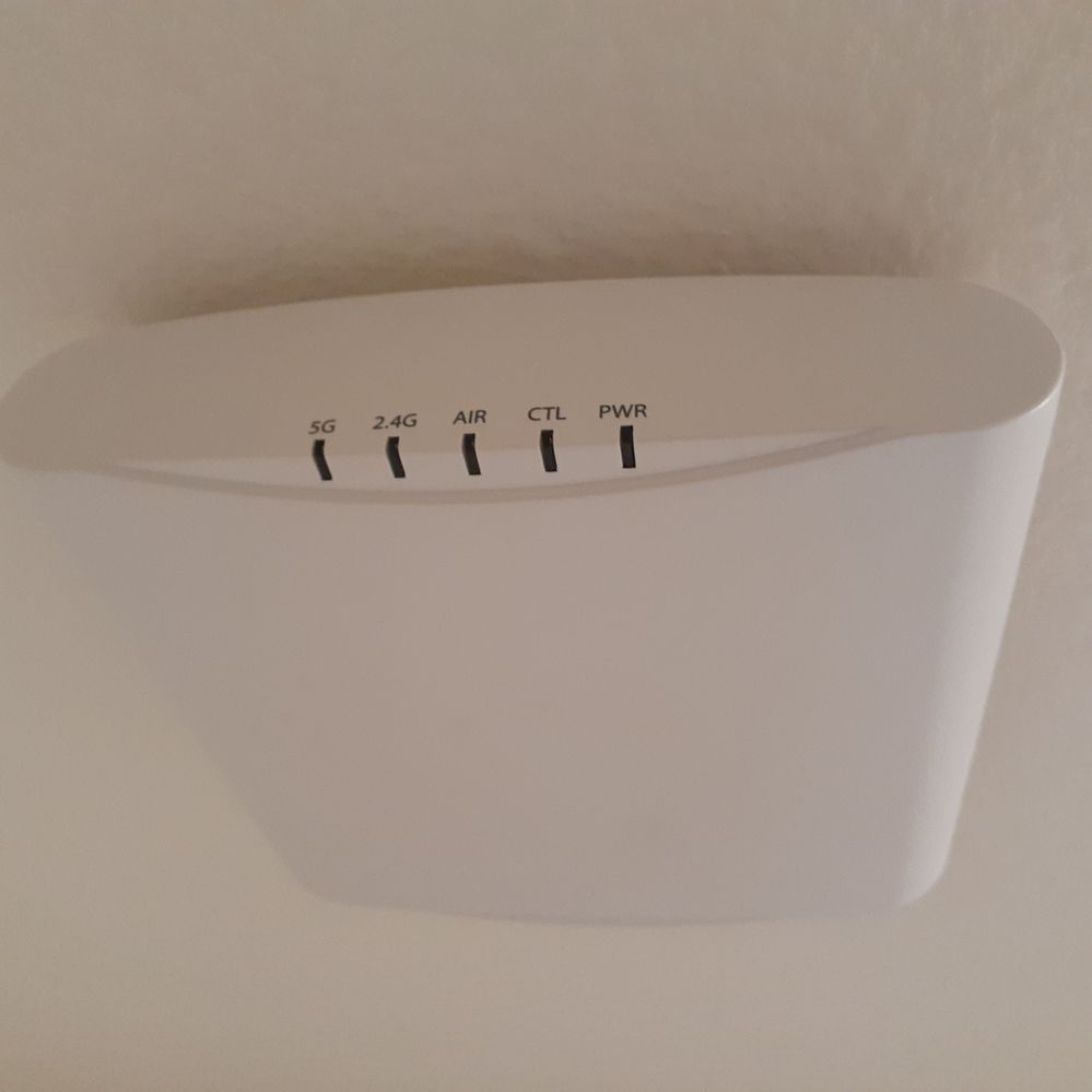

Could you please confirm the light status on your RUCKUS Access Points (APs) mounted on the ceiling? (Refer to the picture below for guidance)
c319917
